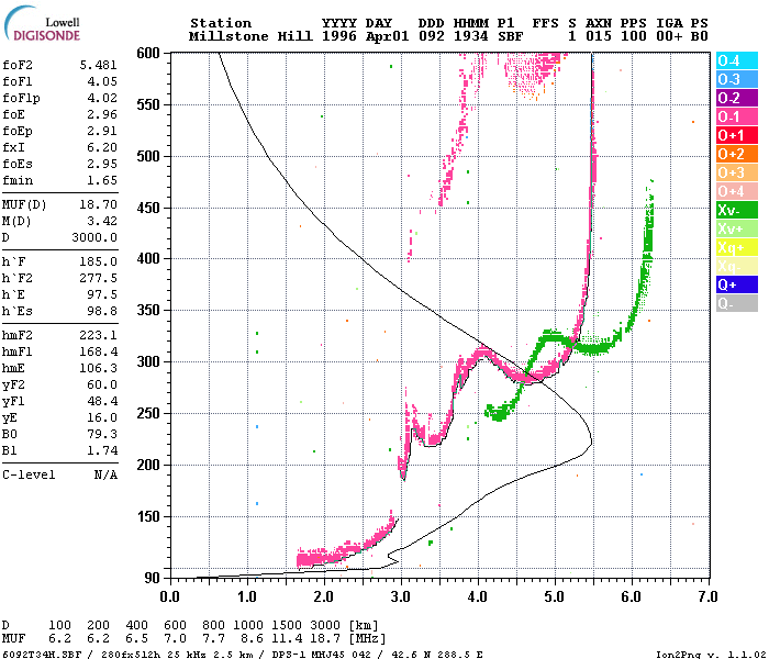

An ionogram is a display of the data produced by the ionosonde. It is a graph of the virtual height of the ionosphere plotted against frequency. Ionograms are often converted into electron density profiles. Data from ionograms may be used to measure changes in the Earth's ionosphere due to space weather events.
The maximum usable frequency (MUF) for radio waves transmitted at a low angle over the horizon is approximate 3 times the highest frequency returned to the ionosonde from radio waves transmitted directly upwards (to the zenith of the location). Therefore, in the sample ionogram shown above, fxI was measured as 6.2 MHz (green dataset), and the MUF for ionospheric reflection at the area of the ionosonde was calculated as 18.7 MHz for a hop distance of 3000 km. The pink dataset, which represents the ordinary wave, shows reflections at approximately 3 MHz (E-layer) and 5.5 MHz (F-layer).

An example, annotated ionogram is shown in the figure to the left. Annotations in this figure are in blue lettering. (Click on the figure to see a full size image.)
This ionogram shows a well-formed F-Layer with a peak ionization at around 220 km. There is also a less obvious E-Layer at an altitude of about 110 km. The ionogram clearly shows how the transmitted digisonde signal splits into reflected ordinary and extraordinary waves. The ionogram chart and the parameter FoF2 in the list on the left side of the chart, show that the highest frequency that will be reflected from the ionosphere for vertical incidence (ie., for a radio wave traveling straight up from the ground) is 4.8 MHz.
The ionogram also shows what appear to be faint reflections from an altitude of 425 km. In reality, these chart points are the result of the sounder's radar signal being reflected by the ionosphere, returning to the ground where they are reflected back to the ionosphere for a second reflection before being detected by the Digisonde receiver. The time-of-flight is, therefore twice that of the normal reflection and the computed virtual height is twice the normal virtual height. This type of presentation is often seen under conditions of low ionospheric absorption.
